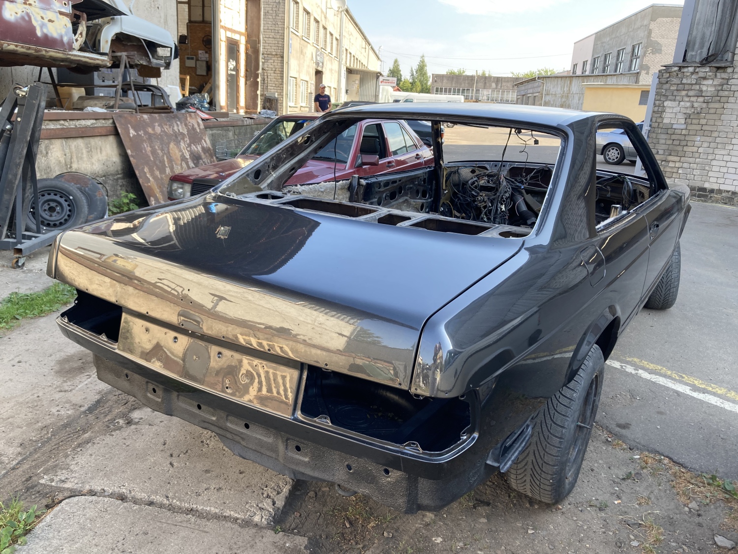

10 months later FINALLY the car is painted. I am about 80% satisfied, but I must say that I am super picky about bodywork and paint. So it actually is very good.
Blauschwarz metallic 199
https://failiem.lv/thumb_show.php?i=db27tzk98

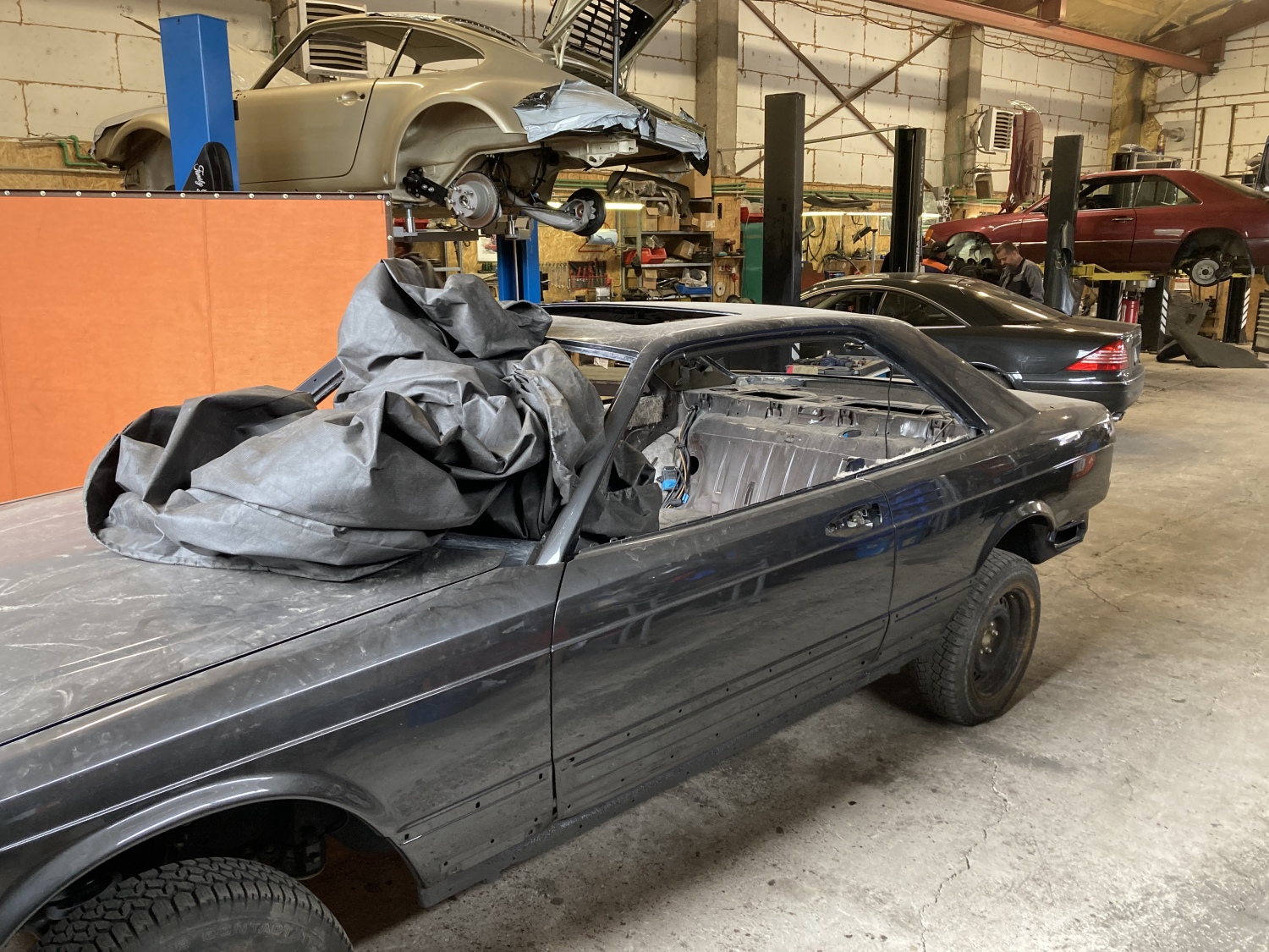

The sunroof was in pretty good shape, minimal rust. The rust was treated and painted, no welding required. There were some cracks in the guide rails and the lifting arms. New OE guide rails were installed and the turkish lifting arms from ebay.
https://failiem.lv/thumb_show.php?i=bsgcxp8u9
The sunroof was not functioning properly before. It is fully operational now.

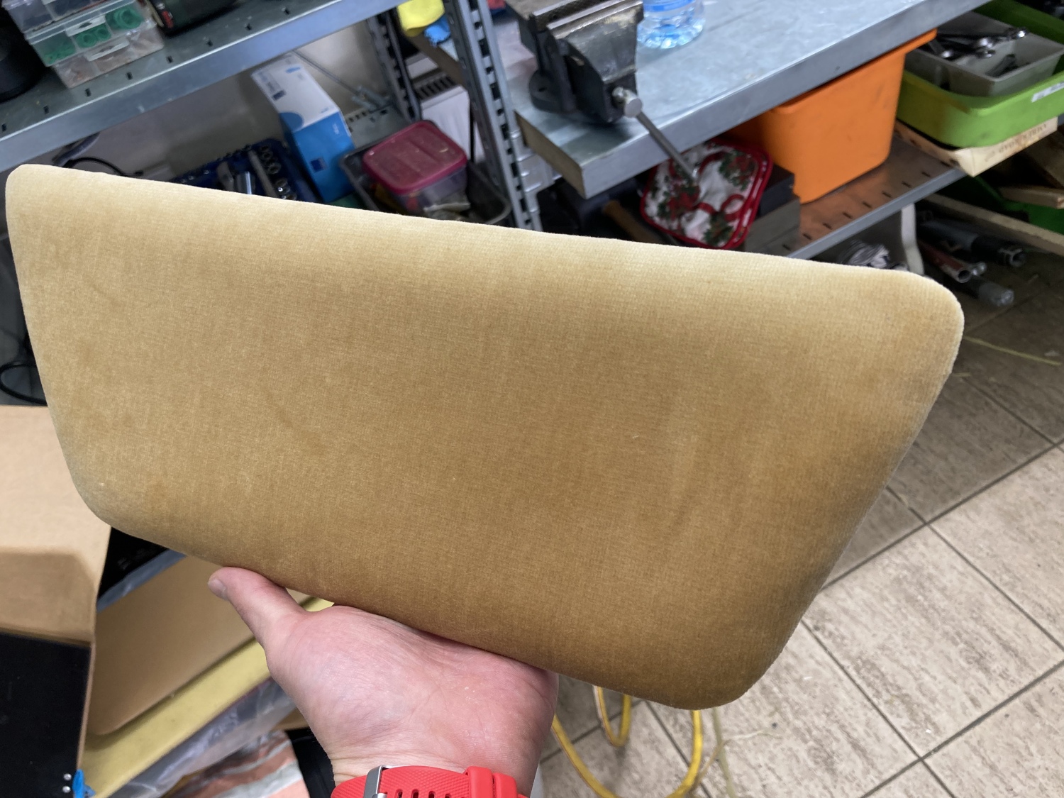

As with every other interior part in Palomino / Dattel color, they are impossible to find. I had to get creative. The footrest was completely destroyed. So I bought a footrest of a suitable color and repainted it / transferred the carpet material.
https://failiem.lv/thumb_show.php?i=c5b5heyhs
https://failiem.lv/thumb_show.php?i=ccbzraqxj
https://failiem.lv/thumb_show.php?i=z5vfkk4ne
